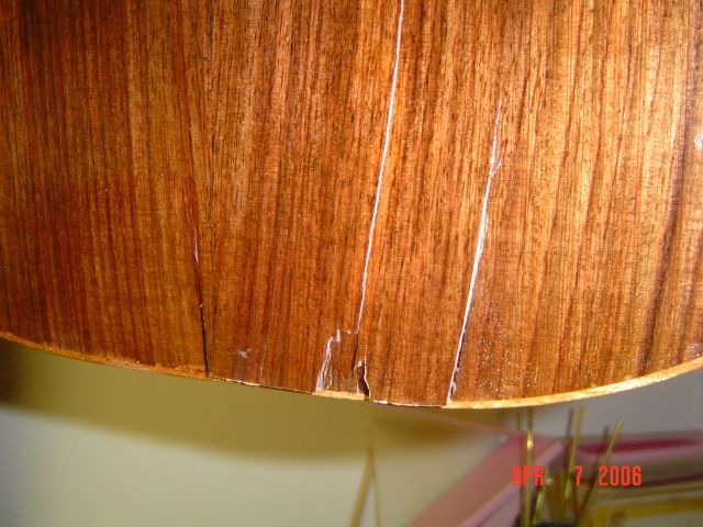

My first guitar. Almost done. Just brushing on some shellac, when the string I had it hanging by came untied and the guitar hit the basement floor with a resounding boom. (On the bright side, I think it was a G#).
The resulting damage is best seen in the picture.
I'm continually amazed by the innovative solutions that you guys have to the various challenged that are presented on this forum. Things I wouldn't have thought of. So I thought it best to run this by you all first in case I'm about to do something awful.
I think that I ought to be able to get the pieces back into position and wick some thin CA into the cracks, and I should be okay. I'll try to get some Titebond between the back and heel block first, push the pieces into place, clamp, and use the CA after the Titebond has set.
The crack stops at the first brace, and the braces appear to be sound.
I'm guessing that some of you have successful experience with similar repairs. I'd be much obliged for any input I get.

I think your fix sounds doable, one other thought would be to replace the back. Sounds like a lot to do, but you would probably be happier in the long run.

Ron, if you can get the wood to fit back together, it will be fine with the CA treatment. But its important to get the wood back together like puzzle pieces, Nice and tight.

You might want to consider using thin hide glue rather than CA for your repair. CA has a tendency to darken the cracks making them even more visible. From what little I've used hide glue it seems to do a better job of making the cracks disappear.

Ronn, I would use medium CA, it won't spread all over the inside of the box like the thin stuff will. Also, I don't think you'll have to worry much about the crack lines darkening to much, all the cracks look like they run along a grain line, so you won't see it if you do it right.

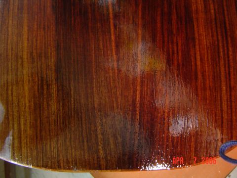

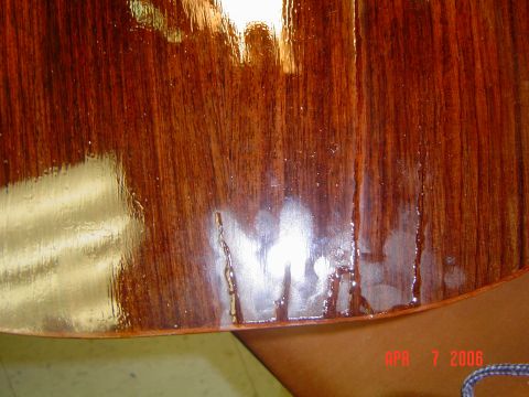

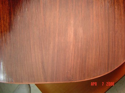

Hi, guys, it's me. I signed on from a different computer and couldn't remember my password. Had to re-register to get on so I could post these:
First, I pushed the wood back into place, and applied some CA to all of the cracks. The wood was mostly level, but not perfect.
Then I sanded it a little. This is looking very promising. I was able to get it level without too much effort.
After a couple of coats of shellac, it's pretty hard to see the repair. It ain't perfect, but all things considered, I'll take it.
